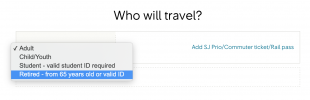

In Sweden, SJ offers a 10% discount for seniors. Available to anyone over 65, just select "retired" when booking.
