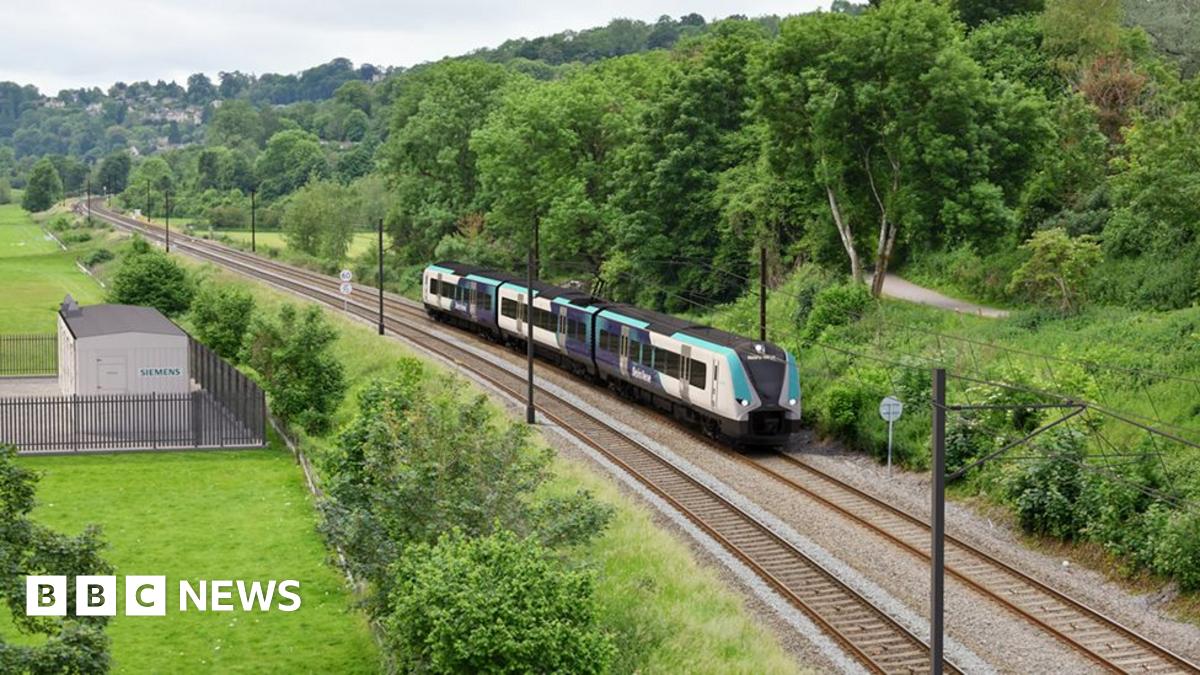

Just spotted this on the BBC website.
A train maker is promoting the idea of battery-powered trains that could be built at its East Yorkshire factory.
Siemens Mobility said the new models would replace diesel locomotives and run on tracks with no overhead electrification.
The firm said if train operators placed orders it would build them at its base in Goole.
The plant is part of a £200m rail village which is building trains for London Underground.
Question is, whose business are they trying to get?
