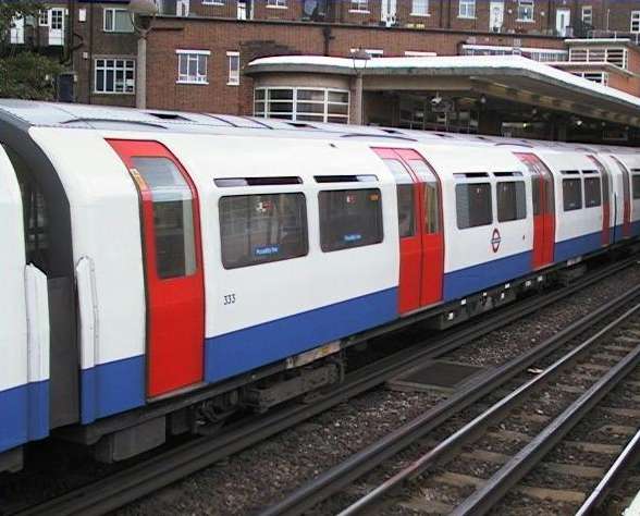

You can tell when 1973TS has been formed oddly, as the vertical fairings intended to streamline the middle of a train 'stick out' from the usually rounded cab end.
I've been unable to find an example image of this, however.
DanNCL
17 Jul 2017
5,005
County Durham
Is this what you're thinking of?
(not my image)
What do you mean by “formed oddly?” Both ends of double ended units are like this, for reasons stated above.
rebmcr
15 Nov 2011
3,930
St Neots
It's still much more uncommon to see that end on the outside, though.
The ‘fins’ are on both ends of the unit, and one end of the unit would always be on the outside because trains are only formed of two units.
rebmcr
15 Nov 2011
3,930
St Neots
There are roughly 20 double ended units. Both ends are fitted with the attachment points for the inter car barriers. So, roughly 20 trains are running with the inter car barrier attachment points at one end.
Ahhh I see. Thanks for clarifying that!
