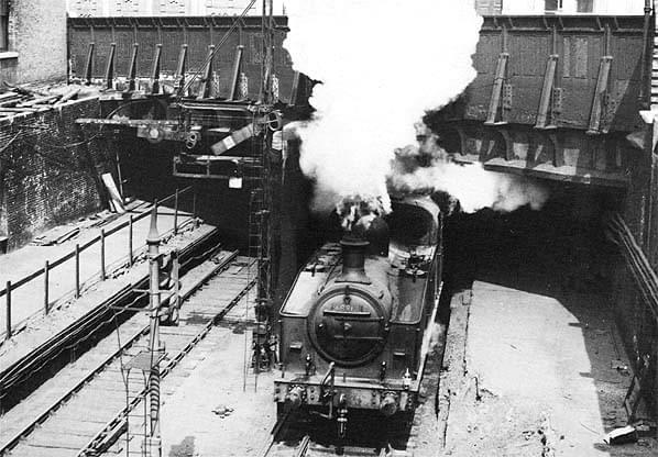

Take a look at this 1953 picture on Wikipedia
It looks like at least one of the lines into the Snow Hill tunnel was electrified. How far did the electrification go and why was it necessary?

This is something which has intrigued me for a long time after having seen a photo in a book some years ago of electrified tracks disappearing into the tunnel, yet photos from the same period of the old Snow Hill station show no electrification. The explanation about the substation seems to fit. This may well be the photo I saw, it's from a thread at RMWeb:
Thanks for posting that pic. That's the best proof so far of the electrification.
Thanks for issuing this photograph. It appears the conductor rail on the left hand (northbound) track finishes in line with the second wagon of the freight train thus explaining why it does not appear in the 1954 photograph of Snow Hill.
