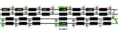

Hey all,
Fleet is my local station and morbid curiosity reared its head when I heard the line to Basingstoke was shut until 4pm. Looking at OpenTrainTimes, I found this:1695983295701.png
Now SHUT is fairly obvious, as is LB-- (line blocked) and 1T34 (train headcode). Does anyone know what -ISO means though? Google only gives me the standards org, which is hardly what I want here.

Sometimes signallers have used the TD berths to commemorate the closing of the panel or the last XC HST. More controversially one wrote "-THX -TPE" after the operator blocked multiple platforms with crewless trains.

Electricity turned off while emergency serves deal with an incident.
This one is, however, more cryptic!
Usually displayed when a 'box is closing or long-standing member(s) of staff moving on/retiring. A similar message was displayed recently when Peterborough panel closed with staff transferring to York.

TD berth messaging are a rare opportunity for us signallers to display creativity; the festive period will usually see TD messages such as:
*HO* *HO* *HO*
APPY XMAS
APPY *NEW YEAR 2023

There is no standard in the rule book for what is shown in TD berths! The only requirement I would insist on is that nothing offensive or derogatory is entered.
They are either headcodes or visual reminders for the signaller usually. This example probably refers to the signalling being transferred to a different location.

Its a way for Signallers to remind themselves, or tell others, what is going on.
Such as -DVR to indicate to controllers that a train is awaiting a driver

Ayr is full of codes I don't understand at the moment due to being fully closed because fire.
The berths with the various SA codes in them show the identities of the isolated electrical sections.
"POSS" is possession.
"APW1" is the Wire item number of the emergency T3 possession that has been taken.
(I have previously had to remind a signaller that thanks to open data, the world can now see what they've interposed in a berth and would they please change it to something less sweary.)

Signallers will use whatever memory device is necessary to remind themselves with the TD. I’ve even seen my initials and department (CHST) dropped onto the TD (via Traksy), clearly to remind the signaller I was dealing with a TC indication fault (not in a line blockage), presumably to remind themselves when **** appears in the next berth that it’s a known fault.
