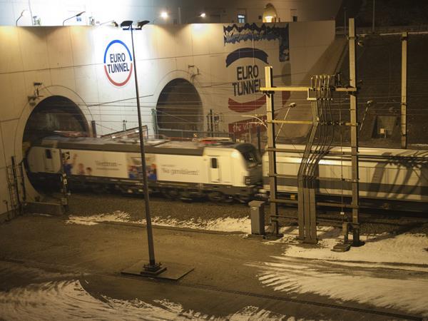

Alstom's Prima II and Siemens' Vectron were also tested in the Channel Tunnel back in 2012/2013 respectively.
Interestingly, the Vectron only needs fitment of TVM and Channel Tunnel-cleared pantographs in order to use the tunnel, according to Siemens. However, homologation for the Vectron (Baureihe 193) in France is not expected until 2024.
