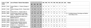

Do Avanti drivers still sign all these potential MAN->EUS routes?
1H74 19:40 (normally, 19:20 today) Euston-Manchester uses the Styal line, presumably as a means of retaining route knowledge for drivers.
1H77 21:45 (normally 22:00) Euston-Manchester goes via Crewe and Styal today, goes via Stoke, Crewe and Stockport on 11/1/22, basically gets routed around planned engineering work. All its calls after Nuneaton are to set down only, which means that the railway doesn't have to cater to pick up passengers at Lichfield, Tamworth, Stoke or Crewe, and it doesn't stop at Wilmslow. Its previous incarnation called at Macclesfield also, but that's now been dropped completely.
The Sectional Appendix is vital here, but I recall that a diversion via Stafford for a service normally using the direct Colwich-Hixon-Meaford routing is allowed without question, but most of the other alternatives would normally be questioned by a driver I suspect.
EDIT See #44 and other posts in that thread for more examples.
NW5009 - COLWICH JN TO CHEADLE HULME Colwich Jn To Stone Jn
Virgin Trains diverted via Stafford. Down and Up trains booked to run via Meaford Crossing L.C. (CCTV) to or from Stoke-On-Trent may be diverted via Stafford without previous warning and Drivers so routed need not observe the requirements of Rule Book, Module S7, Section 1.2.
If a Down train is booked to call at Stoke-On-Trent or Macclesfield, Drivers of trains on the Down Slow line must stop and challenge the route at Searchlight Lane Junction (signal SC5609) if not routed towards Stone Junction. Drivers of trains on the Down Fast line must stop and challenge the route at Norton Bridge Junction (signal SC3605) if not routed towards Stone Junction.
Dated: 31/05/16
