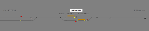

but anyway, back to reality and a £14mn siding at a lightly used station thats a bit of a connecting transport bottle neck…
Network Rail is to trouser £3mn, to make a report reccomending 3 signals, few panels of track and moving some probably life expired signalling cable routes…. So my suggestion would probably cost hundreds of billions. Elsewhere in Europe a siding would be simply done in a few weeks.

The quoted cost of £14M seems extraordinarily expensive for building a turnback siding, but feels a little on the cheap side for doubling to Belmont, considering that doubling would require building a 2nd platform. Knowing the railways, 'extraordinarily expensive' is probably more plausible than 'cheap' ;)
IIRC a large factor for the price tag is that the branch will need to be resignalled as only one train is allowed on the branch at a time?
Ah, right. So if I've understood you correctly, you mean the whole branch is just basically one ultra-long siding, with no signalling at all beyond the point where it becomes single track?
Sm5
21 Oct 2016
1,013
Not quite, there is a signal both ways at Epsom Downs, so a unit can be locked into the platform there, allowing something else, onto the branch, usually to switch platforms at Sutton, but presumably could wander up the line to Banstead.
Signalling would obviously be needed into / out of and protecting the Siding movements.

No way the whole branch will be closed for 2 years. If I were to guess, trains will turnaround at Belmont for most of the time and have replacement buses to Sutton
MarkyT
20 May 2012
6,956
Torbay
Assuming an equal interval more frequent service then just the ability to reverse a second train at Belmont while another train is between there and Epsom Downs should suffice. This would require additional signals on the single line but no extra platforms, junctions or sidings. This would however pose additional performance risk if the second train had difficulty reversing at Belmont, trapping the Epsom Downs train on the branch extremity. It would also limit flexibility for longer turnround margins at Belmont. Having a turnback siding on a single line seems to make little sense unless longer turnround layovers were required to fit in with other services elsewhere, or it was only used in emergency to get a train that couldn't proceed in the correct direction in passenger service off the single line. My solution would be as shown here, a stepped platform like LO at Clapham Junction, with the ability to also reverse in the new through platform if the bay was blocked for any reason.
MarkyT
20 May 2012
6,956
Torbay
That just looks like a glorified siding to me
KInd of, but a non-platform siding requires more movements and two platform occupancies to terminate and unload, ensure empty, move clear, change ends and restart. A terminal bay can accomplish this all in one operation, all clear of the running line. While a separate second platform could plausibly be built/reinstated to the west of the former up line, that would require an expensive access bridge with ramps or lifts, while my stepped platform suggestion could share the existing level access.

I looked at the weekday midday timetable of the branch and got this, repeating hourly. Future shorts are in brackets.
Sutton12:19(12:34)12:49(13:04)
Belmont12:22(12:37)12:52(13:07)
Banstead12:2612:56
Epsom Downs12:29 12:59
Epsom Downs12:3813:08
Banstead12:4113:11
Belmont12:44(12:59)13:14(13:29)
Sutton12:47(13:02)13:17(13:32)
So the trains that leave Sutton southward will return northward in the same order, but the shorts will have waited 22 minutes at Belmont instead of nine minutes at Epsom Downs.
It seems better to me to redouble from just south of Belmont to just north of Banstead, and run all the trains to Epsom Downs without building any new platforms. The southbound trains would have to wait a minute or so to get access to the single track at Banstead platform, but surely this is worth it for a doubling of service.
30907
30 Sep 2012
20,668
Airedale
Depends if Banstead and Epsom Downs have the traffic potential to justify doubling the cost of the project, and setting the timetable in stone based on the crossing loop..
Banstead12:2612:56
Banstead12:4113:11
Thanks for doing the timetable exercise. That shows conclusively that on an even interval, you can't just run another train to Belmont behind the Epsom Downs service and reverse it after a short turnround, hence the need for a reversing siding. Such a facility could plausibly be a first step towards implementing your interesting long loop idea. Banstead could plausibly become a more important railhead if it had some car parking spaces at the station and access improvements to the platform. I always felt Epsom Downs station might more usefully have been relocated at Drift Bridge in Nork, both for easier bus and pedestrian access from a wider area and availability of land for car parking. Amusingly, it might also be renamed as Nork!
