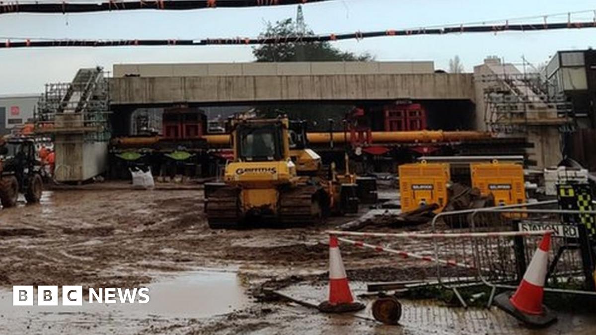

Construction Enquirer reports problems with the replacement of Gipsy Patch Lane Bridge:
"Contractor Alun Griffiths was edging the 4,260t replacement bridge into place when the two Osprey self-propelled transporters sank into the mud 30m short of their final position.
The contractor is now racing against time to solve the problem so it can reinstate rail journeys from Bristol to Wales which were disrupted when the original Gipsy Patch Lane rail bridge was demolished to make way for the weekend bridge replacement.
Two dozers were drafted in to try to shunt the transporters forward but these are understood to have failed to budge it.
Network Rail had said prior to the weekend it was due to reopen next Saturday, but the disruption is now expected to continue for longer than originally anticipated.
A South Gloucestershire Council spokesman said: “Despite detailed planning and preparation, our contractor, Network Rail, has encountered a significant issue moving the new 4,260-tonne Gipsy Patch Lane bridge into place.The bridge, which is already built, is being moved into position on a number of independent hydraulic transporters. Having successfully moved two-thirds of the way into place the bridge transporters are now stuck.Our focus, alongside Network Rail, is on resolving the issue so that the bridge can be moved into position. This is likely to take a number of days and will delay the reopening of the mainline.”

Normally these sort of transporters seem to be operated on a very well prepared temporary surface, often with steel plates on the running surface. I’d not heard of any massive failure due to sinking before, I’m sure it’s the sort of thing that would be highlighted by the normal media.
There was a local BBC report yesterday that referred to the transporters as “lorries” in the headline...

Attempts are being made to lower the bridge where it currently is after the transporter sank. This means that they are trying to create a tarmac runway for the bridge to be supported on in the interim and then slowly reload it back onto the transporters. However even if this is successful, it wouldn't be until Monday that the bridge is in place, with another week after that until the line reopens.
The attempt to dig out the earth around the transporter wasn't successful, so it must have been very wet indeed.

Five ballasted heavy haulage vehicles and a dozer managed to drag the bridge carried on six transporters onto firmer ground yesterday.
The concrete bridge got stuck when its was being moved into position following the demolition of the original Gipsy Patch Lane rail bridge.
The Network Rail replacement project was due to be completed this weekend but is now set to overrun by several days disrupting rail services.

If the overall support of the concrete structure has been seriously out of spec, could it be damaged or distorted?

Uncorroborated local reports are saying there is slight damage to the bridge.

The moves to get the bridge in position should all be completed by Sunday evening. South Wales services are diverted via Gloucester today and terminate at Bristol Parkway tomorrow with buses to Newport.

For a trade publication, it's rather poor for such an in-accurate description used to described the image in the above post:
"Five fully-laden quarry wagons and a dozer managed to drag the bridge carried on six transporters onto firmer ground yesterday."
Strangest looking tippers I've ever seen. Although I must admit a rather nice lash-up of Alley's tractor units.

Given the heavy rain which preceded the incident, even the supertalented weirdos and superforecasters of Downing St should have foreseen the need for a harder surface for the bridge move. To continue without was, in my view, rather negligent.

The bridge is now in position and the track and OLE are currently in the process of being installed. Earlier Monday morning is when the line is expected to reopen.
