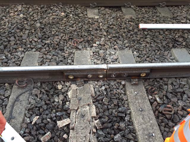

Picture of the damaged rail
gavin
25 Dec 2006
1,006
Broken rail joint and sleeper is the problem

Lines are now reopen delays expected till around 15:00 whilst services recover
CPa4YldWcAAhURX.jpg:large
Looks like the joint was broken a while, judging by the indented rail end and consequential broken sleeper from the impact loadings?

Corect! Trains cautioned until P/Way on site ... I would imagine their opening phrase was akin to 'oh dear' :lol:
I would have thought it would have been about 'more than three waterways'!
Think about it! ;)
That sleeper has been hammered to within an inch of its life!
