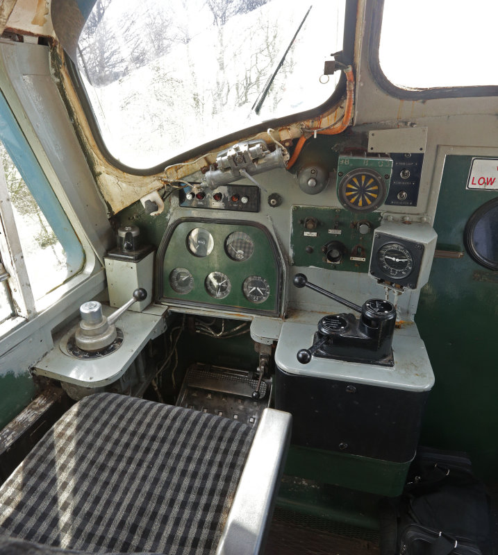

Hi,
I'm booking a loco driving experience and have never been in the cab of any type of train, let alone drive one.
I've been looking on the net for some web pages showing the cab controls of a class 31 or class 37, as it's one of those classes that will be used on the experience day.
I've had no luck finding web pages showing this.
Can anyone please point me in the direction of where I can find this (if it exists at all).
Thanks in advance.
Richard.

Hi this is the cab of a 37 I had the pleasure of driving at ELR recently
Engine and train brakes on the left
Direction and throttle controls on the right
Feet operate the "dead mans handle"
And the most important lever. ... The horn by your right knee. :)
more photos if you are interested here.
http://www.pbase.com/amjones/drive_a_diesel

Hi Holmbridge,
Thanks for that, just what I was looking for.
I also looked through all the other photos in your album, looks like it was a great experience.

I've yet to Drive a 37 but I notice from the pictures that visibility looks poor out of the windows. They seem quite high up and small. Is this a problem when driving these?
We have a dwarf DD at our place. I would think he would have trouble if he had to sign 37's.

I've driven a Cl 40 on a driver experience day on the ELR - yes the cab windows are high compared to some locos, but no visibility issues when sitting in the driving seat (obviously after getting used to the bonnet). Thoroughly enjoyed it and highly recommended.
Wasn't a big issue, you get used to it quickly.
