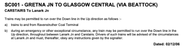

The "local instructions" mentioned in the Sectional Appendix extract above are:
SC001 - GRETNA JN TO GLASGOW CENTRAL (VIA BEATTOCK)
CARSTAIRS To Lanark Jn
Trains may be permitted to run over the Down line in the Up direction as follows :-
a) trains to and from Ravenstruther Coal Terminal
b) during an emergency or other exceptional circumstance, any train may be permitted to run over the Down line in the Up direction, throughout between Lanark Jn and Carstairs. Drivers of such trains wil be advised of the circumstances at Lanark Jn and must, thereafter, obey any instructions given by the signaller.
Dated: 02/12/06
