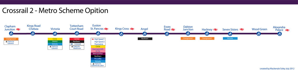

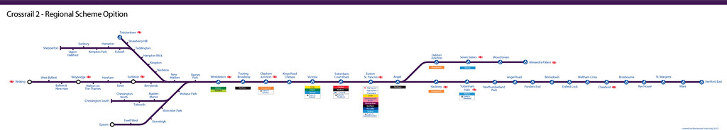

Crossrail is not open and the next major project being planned and hotly debated is HS2 and there are many other projects around the country which would provide extra capacity which could be just as worthy, if not more so, of funding. Those subjects all have their own threads for discussion and we needn’t repeat ground which has been gone over again.
Therefore if Crossrail 2 was announced to be going ahead what would you like it to look like and what other linked projects would you like to see to provide the best benefit to the rail network?
In answering the main question there are various questions which you may consider including, but not limited to:
Should it be an automatic metro or regional railway?
(http://www.transportxtra.com/magazines/local_transport_today/news/?id=28776 provides maps of the two options, but requires a subscription to read the full article)
What railway and tube lines will it relieve and what other projects could be undertaken to provide further capacity to these lines?
Where, other than within the M25, could benefit and what new services could be run to these locations because of it?
Personally I would like to see it as a regional railway freeing up a lot of paths into Waterloo. This would make putting up the overhead wires over the whole SWML a lot easier and enable a lot more longer distance services to run from Hampshire, Wiltshire and Dorset into London as well as providing the future to extend some of these services as far as Devon if there was the demand.
I would also line to see a link so that some of the services which run into Victoria can run into the tunnels with the option to add more tunnels to further free up Victoria being investigated.
There would probably be some fairly major linked projects to enable the extra services (grade separated junction at Woking). However given how busy the SWML such services would be well used from day one by providing relief to other services, however over time all the services would soon become fairly busy again. As the M3, A303 and A3 corridors are fairly busy with traffic and could do with extra rail capacity to provide an alternative to driving.
Within London as well as directly relieving the tube lines it runs in parallel to it could also reduce demand on underground services which are not directly linked to the current termini which would be being relieved as the change points of peoples journeys would change.

Current thinking for the line is either of these,
Metro
Crossrail 2 Metro Scheme by Sparkyscrum, on Flickr
Regional
Crossrail 2 Regional Scheme by Sparkyscrum, on Flickr

Cheers for that as I was unaware that they were doing so.
Though why does the Metro scheme not have interchange with any tube lines at Kings x?
jopsuk
13 May 2008
12,773
Version 2 would seem the more useful, especially if coupled to schemes such as four-tracking from Tottenham Hale to north of Broxbourne- allowing Crossrail to have separate tracks
the "Euston St Pancras" interchange should really have Overground marked, and Victoria a BR arrow, whilst the "Trains to Gatwick and Luton" box should perhaps be grouped with the HS1, HS2, Thameslink and maybe a separate line for other National Rail services? It would certainly be the best connected rail hub in London. I wonder how many platforms, including the duplicated Northern, Victoria and Subsurface lines, the complex would have, taking into account the Euston rebuild?
