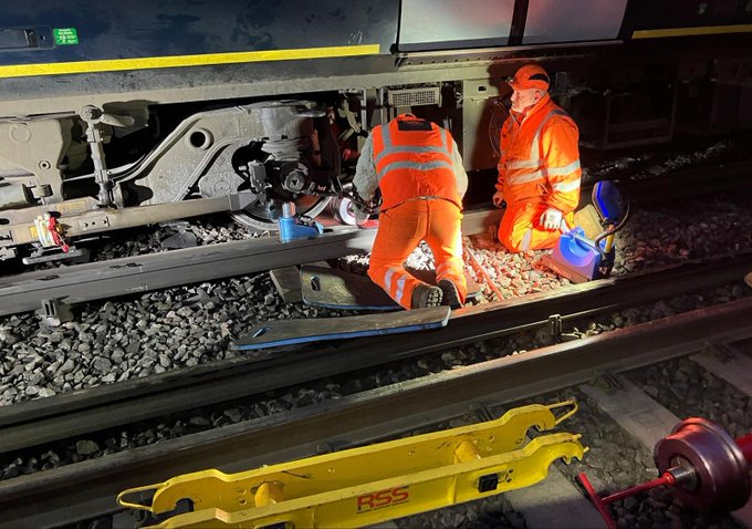

Good thing is that they've re-railed 450092. Just putting skates on according to Network Rail Wessex
GH2N0GFWkAEcpi8
Nicholas Lewis
9 Aug 2019
6,182
GH2N0GFWkAEcpi8
Rerailing teams are very good in my experience despite fortunately not having to do this very often often left hanging around waiting for access whilst investigations are done. If the sleepers are scored rather than cracked may be able to open in the morning with just a ESR over affected area although I suspect at the point of derailment a few sleeper will be severely damaged from the initial high impact.
Samzino
5 Dec 2020
1,179
Seems sleepers weren't too damaged, this is the work they expect to do overnight:
