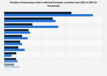

They use Heat Pump technology, which frankly is useless in cold temperatures.
Lots of heat pumps sold in cold countries (for heating buildings, not buses admittedly).
