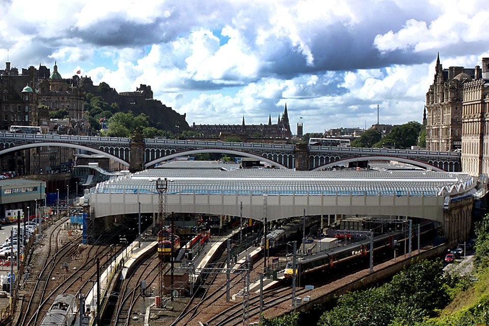

Would need modification/demolition of the parcels deck
What's up there, out of interest? Presumably no parcels since the opening of PRDC.
