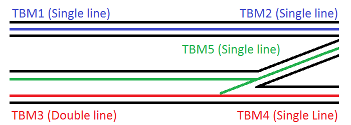

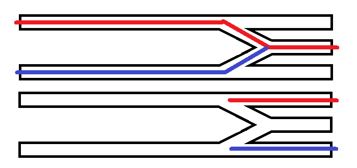

I don't know what the envisaged construction method was for the three tunnels, but I can see two options:
1. Tunnel from one end to the other using three TBMs.
2. Tunnel from either end and meet somewhere in the middle (using six TBMs).
With option 1, you would still have three TBMs, so yes, the only the part of the cost that is proportional to tunnel length would be saved. However, this is not an inconsiderable cost. You have huge costs associated with manpower, tunnel linings, spoil removal and so on. Besides, with the number of tunnels involved with HS2, I'm sure they'd get a group discount! :lol:
I would also add that the "International" TBM would be finished long before the "HS2" TBMs. This would present options with regard to the critical path, and possible redeployment.
With option 2, there would be six TBMs on the original design (I assume, based on the link tunnel being almost as long as the HS2 tunnels) and five in my proposed scheme. This would also have a shorter path, giving options for possible redeployment.
I suppose one way to get rid of the underground junctions would be to make one of the tunnels take two lines instead of one. This assumes that the additional costs from a larger-diameter tunnel are less than those from a separate tunnel. Again, I don't know the figures. Something like the below is what I imagine would be the case.

From what I have seen it looks like the plan would be only to use 3 TBMs, primarily because: there is no shaft in the middle where they could be recovered later, the distance involved is not long for a single TBM drive and the limiting factor for the construction timetable is the work at Euston and the Chiltern tunnel, so finishing this tunnel any faster would not be particularly useful. The problem of there being no suitable intermediate shaft location also makes the option of having a two-track bored tunnel extremely difficult as well, so that might not be as much of a solution as it might seem either.
I don't think it would be as easy as you believe to do such an enormous dig operation in between the two running tracks of a route. The amount of space available for construction workers would be extremely narrow and at the best of times, when the trains are not running, there would only be at most one narrow access point where it reaches the surface. Launching a TBM from that location might be possible for the initial construction but there would be no way of feeding it the supplies it needs to continue working, so it would only be possible to recover it from that direction which would still be a challenge in itself. Unfortunately there really don't seem to be any easy solutions to the HS1-HS2 link other than what was included in the Hybrid Bill, or the option of a fully-tunnelled link which would have to go all the way to Barking and cost more than Euston for the sake of a few hundred passengers a day.

^^^ This is why I'd like to see HS2 have a real look at the options for this section, taking expert advice from those in the know. Any idiot with crayons (ie me! :lol: ) can come up with crazy schemes but it needs a group of people that can produce workable plans.
If tunnelling from Primrose Hill is a problem, then tunnelling to Primrose Hill might be the solution. I'm basing the sketch below on my understanding of the construction of the Channel Tunnel, where one machine was diverted off line, and the other machine finished the tunnel off.
Here's the original route engineering report from the original March 2011 HS2 announcement. It gives the cost and general idea of the three options - single track classic speed, double track classic speed and double track high speed and gave indicative prices for each.
Are you suggesting leaving the TBM in-situ, like some of the Channel Tunnel ones?
