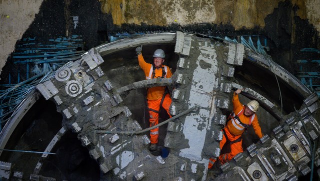

TBM Lydia has broken through into the Old Oak Common box, as reported by @philatrail on twitter.
This is the logistics tunnel for the Euston - OOC tunnels that will hopefully still happen.
Picture credit to Phil as linked above.
21,045
The HS2 web site has yet to catch up with Lydia's breakthrough.
The job (853m) has taken almost 9 months.
Lydia was rebuilt from one of the Crossrail TBMs.
The flooded chamber for the Euston TBMs ("Old Oak Lido" - see the X link above) looks challenging.
Later on Jan 23:
The HS2 web site has finally caught up with Lydia's breakthrough with some official pictures:
HS2’s London tunnels contractor, Skanska Costain STRABAG joint venture (SCS JV) constructed the logistics tunnel using a TBM made from components repurposed from a machine previously used to construct London’s Elizabeth Line. The TBM is named Lydia, a name selected by the local community, after Lydia Gandaa – a former teacher at Old Oak Common Primary School.
The TBM broke through into the eastern end of the Old Oak Common underground station box, which is currently under construction by a separate joint venture – Balfour Beatty Vinci SYSTRA (BBVS JV). Later this year, SCS JV will lower two additional TBMs into the box and assemble them ready to bring the HS2 line into Euston. Once they are in place BBVS JV will seal the box and continue to construct HS2’s super-hub station.
Although it doesn't say so, I imagine the Lydia tunnelling team will move on to the nearby Northolt East TBMs, to be launched soon.
