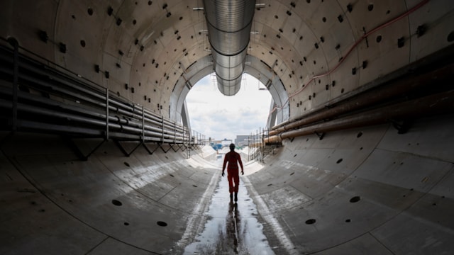

HS2 has issued new update video 9th May 2024
It confirms over half of HS2 tunnelling is now bored
