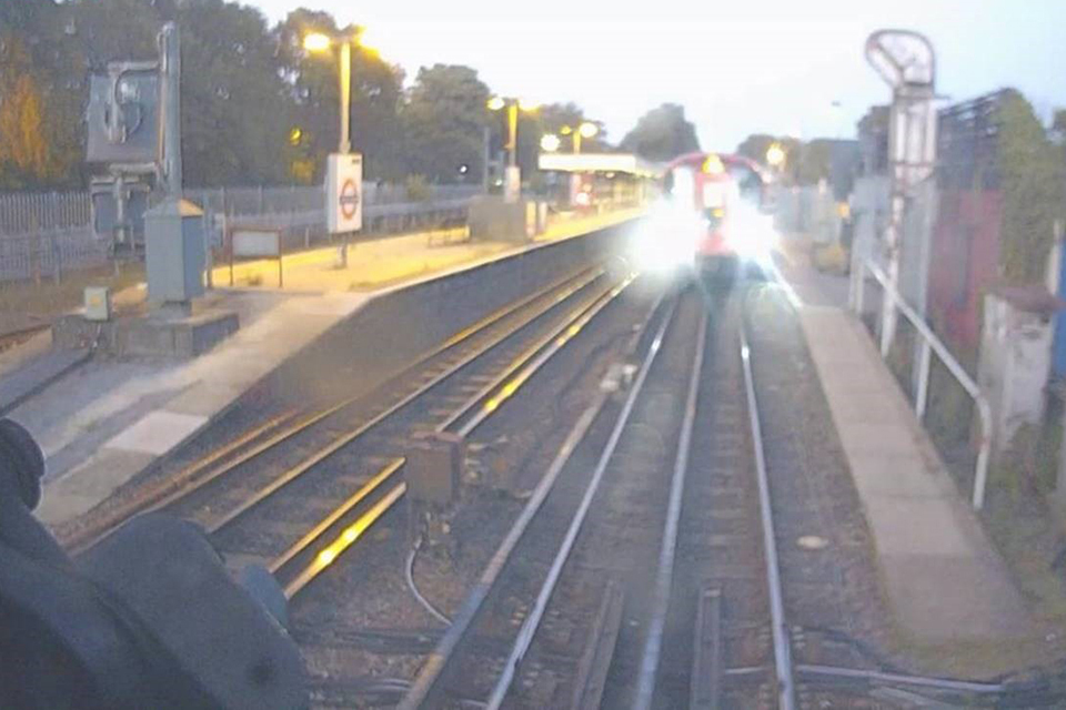

Looking at the images I struggle to work out how the Chiltern stopped where it did, had it being doing any sort of speed it would have travelled further than that, assuming that the driver realised his error when he saw the way the points were set.
My gut feeling is that had the Chesham service moved then the Chiltern service would have had time to stop.
I also suspect that the signal would revert to red immediately following the spad, and if I am correct this would also have mitigated any risk as the chiltern driver would have loads of time to see the other train moving and act accordingly.
Once the Chiltern train had the spad it would enter the signalling section which the Chesham train was going to use causing the signal to go back.
It could be (arguably) said that the Chiltern driver was unlucky as had the Chesham train moved he would have realised his error and acted differently.

The Chesham train had started moving, but had not passed the signal when the road went back on the driver and emergency brakes were applied
I can't see the logic in saying if the trains were closer together (Chesham having passed the signal) then it wouldn't have been so bad? It's likely that had the Chesham passed the signal there would have been a head on collision possibly even fatalities. The Chiltern driver would most likely assume the LUL train was heading to Amersham on a non-conflicting move until it crossed the points. The LUL driver would more likely notice something is wrong but as far as I'm aware the S stock does not have hazard lights like mainline trains do, and has a whistle and not a horn. Also, as far as I am aware, LULs Connect radio does not have a facility to stop other trains like GSMR does.
S Stock do have hazard warning lights.
