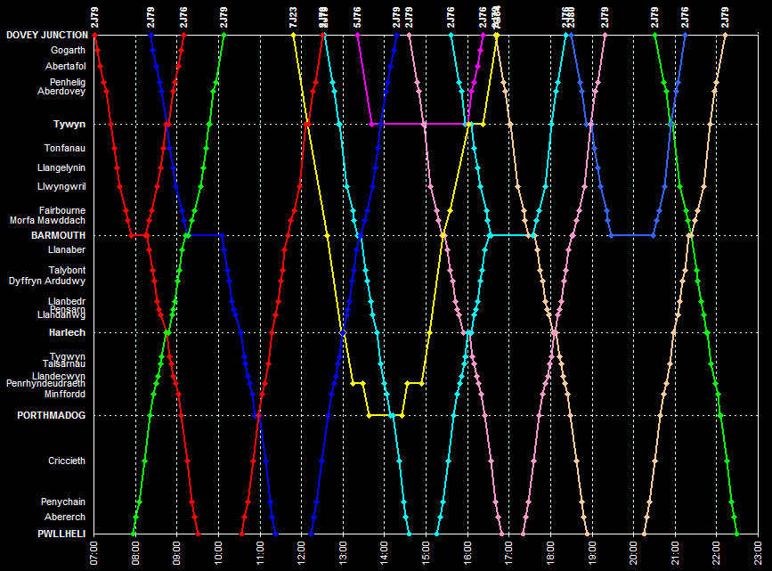

Edit: and here is a nice image of a train planning graph for a single line. I don't know how the interfaces at junctions are modelled though:
There is another section of the graph above or below, with the junction name repeated at the bottom or top, and then showing the other places on the diverging route. Trains taking that route have a vertical line at the junction to link them across the graph sections.
That looks very effective! Might have a go at doing one myself for my local main line.
Also, where there are two separate lines of the same colour, does that mean they are both operated using the same multiple unit/locomotive? Just curious as all lines on the graph seem to form a peak or dip at some point.
Not sure why there are so many colours. You'd normally have different colours to show the trains running on different lines (SL/FL) but that's obviously not the case on the Cambrian example given!
Yeah, it seems to be, which is actually unusual as from a planning perspective that info isn't vital, and can be worked out in different ways.
Normally different colours are reserved for different lines, either SL/FL for example as nedchaster says, diverging routes, sidings (very useful where there's loads of locations in close proximity) or even diversionary routes, so you can see if you're struggling for a path via one if going via the second is a possible option. In the past graphs have included Gainsborough Trent Jn to Barnetby via both Brigg and Lincoln. Differentiating lines can also be done with solid, dotted and dashed lines, and a combination of everything depending on the system so you can see at a glance which sidings might be on the up or down, so it's easy to see if movements conflict. Such ones can look messy at first glance but IF DONE RIGHT should be very easy to use with a basic knowledge of what they're portraying and how, without necessarily knowledge of the railway geography.
Coloring by service group / origin-destination pair / timing load etc. can be useful in some circumstances

Planners will have their own settings on graphs like this, most go for red and green for distinguishing between fast and slow lines. Some don't, some use black and red for fast and slows due to colour blindness, you can have any combination in some systems including dashed --- lines. In some ways the type of unit doesn't need to be known, a decent Planner can tell by either information contained on the graph (headcode), by calling pattern, location or by the angle of the line on the graph which infers speed. Using a graph, signalling diagram and the Timetable Planning Rules you then build up the graph. A lot is done manually by the human eye but software is getting better and better at pinpointing where needs looking at.
