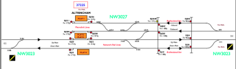

Is there capacity at Altrincham or Stockport for a terminating train? Turn back sidings, signalling etc?
jfollows
26 Feb 2011
6,111
Wilmslow
Not at Stockport. Reverse over the viaduct (not practical) or run to Longsight (or Newton Heath) and back (too far).
Stockport layout: https://www.railforums.co.uk/threads/heaton-norris-denton-signals.258549/#post-6538505
Altrincham platform 3 has DJ25:
EDIT At Stockport it would be possible to reverse on the Denton line after Heaton Norris Junction but I understand there are no paths for this across the junction.
