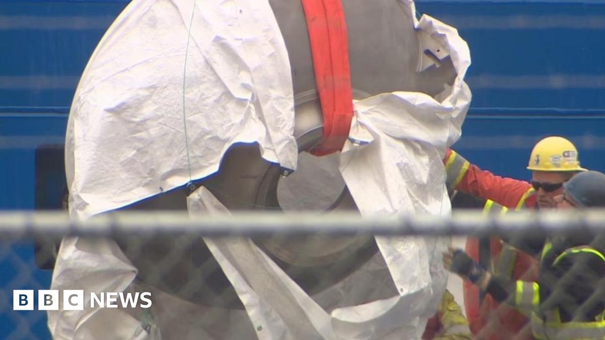

Images of the parts being brought into port have been captured. A strap lifting the titanium front section seems to be going through the porthole window, which does make me wonder if it failed?
That said, the titanium front section seems to be in one solid piece still, unlike the minced sections of carbon fibre. Maybe if they'd made the whole submarine out of this ......
It's been widely reported that the porthole was a type certified to a maximum depth of 1,500m so it would not be surprising if that turned out to be the main point of failure would it?
I’ve also heard that and the fact that it was seen visibly flexing. All in all even if half of the things said about the Titan turn out to be true, this incident was inevitable.
Things flexing is not unusual, I read somewhere that it was designed as a plug so would push harder into the hole it was blocking.
But if it flexes too much...
Very true! Seems like there wasn't one likely failure mode, but something like a hundred. Deducing which one actually led to the untimely demise of the sub will be a challenge, considering there are so many likely contenders.
