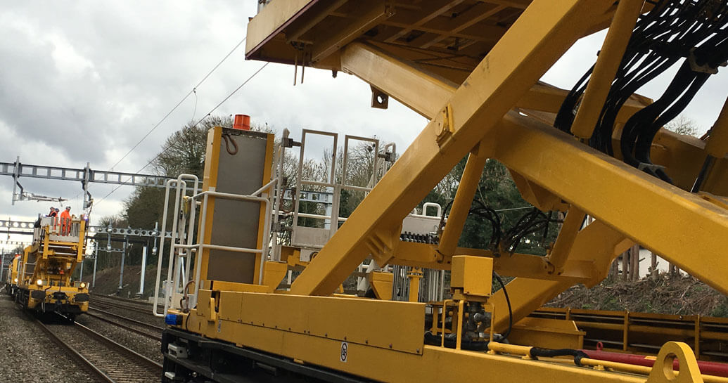

NRs High Output train is supposed to be able to do about a mile in an overnight possession.

I suspect next weekend's possession through Market Harborough would suffice. Plus overnight snagging as needed.

Yes all the infrastructure is there, they "just" need to swing the insulators through 90 degrees and put the catenary and contact wires up.
