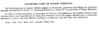

The Puddock
10 Jan 2023
482
Frog
Can anyone please explain if these whistle codes were standardised (like signalling bell codes), or were they specific to individual locations?
There were both standard and local codes. The standard ones were listed in the Sectional Appendix (the entry from the 1960 ScR issue is attached) and local codes were variously given in the Sectional Appendix or published separately, depending on the time period and region. Many of the enginemen's Mutual Improvement Societies also published small pocket books listing whistle codes, as well as other handy miscellany such as location of water columns and troughs, locations and lengths of turntables etc... (image of an example from 1954 included below).
I'm guessing these local whistle codes were a throw back to the days before the big four? From what I've been told on other threads old habits persisted.
