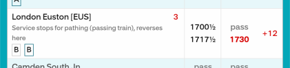

This entry refers to another train passing. I assume that there is a timing allowance because of another train on another platform meaning that this train cannot move out of the station.
I think the poster is referring the the time being recorded as a pass, rather than the pathing stop.

I'm guessing as its not a technically scheduled stop it is only there to reverse b
No the incorrect activity codes (RM,A) have been published; which have then been picked up on down steam systems to produce this word soup. Personally RM or RM, OP at a stretch would have done to advise operating staff what was happening to this service at this location.

RM is quite correct - the train reverses there.
A isn't inherently wrong - it refers to a stop inserted for pathing reasons, and I'm sure the train could leave earlier if a path were available. But since the train has to stop there anyway to reverse, it's somewhat superfluous.
RTT's "translation" of activity code A is not entirely accurate - whilst it can be due to awaiting a passing train (e.g. at a a loop on a single track route), it is also used when simply awaiting a path on a double (or higher) track route. The section in the brackets "(passing train)" just needs to be replaced by "reasons", then it would be correct and cover virtually all foreseeable scenarios.
This issue has been raised before; the same goes for incorrect or incomplete "translations" of cancellation reasons, e.g. MS being shown as "replaced by a slower train" which doesn't properly reflect its actual usage. It's a shame really, because it is an incredibly useful resource overall. It's just a shame that the people behind the site don't seem to want to listen to people who actually use and allocate these codes in real life...

My view for most of these codes* is that if the definition of it in the code dictionaries that we have access to are wrong then they are the things that should be corrected. It is no good saying that a code is used in this way and the official definition not being appropriately used. I believe that the reason it shows the current definition is due to a discussion in this very thread.

The issue is complicated by four main issues:
1. There are often multiple different definitions depending on the sources you look at (e.g. in TPS I'm fairly sure the definition for 'A' is 'Train stops or shunts for other trains to pass') this leads to:
2. There are differing understandings about how to apply all the various codes.
3. There will always be situations where the codes cannot be applied strictly. Particularly for services that are 'unusual' such as charters or departmental trains.
4. Sometimes planners get the codes wrong. It happens, there's no way for the computer to know it's an A stop not a OP stop, for example (at least not without a whole load of other data being uploaded into the system).
These also apply to all the other data RTT gets from the feeds to varying extents.
Fundamentally, for 99% of users I think RTT gets the balance of these messages right. And for the cases I personally wouldn't do things the same way, I accept that @Tom has spent the time and effort to build the site and therefore gets to make those calls, and I just quietly thank them for the fact it exists at all.
