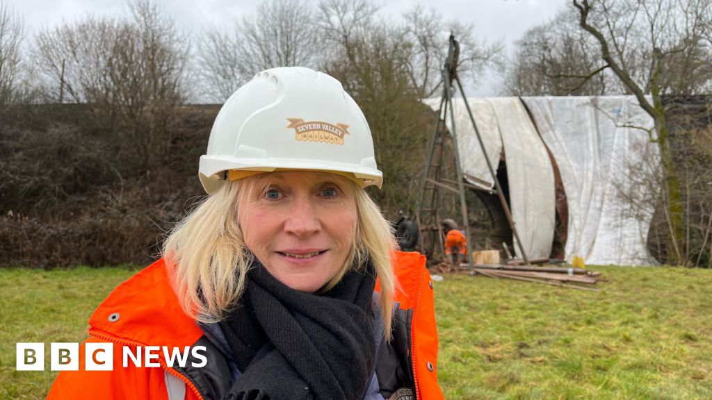

Not much in the way of new updates, but here's another article on the incident.
BBC News - Work begins to find cause of railway landslip
From the BBC report, they finally mention the wing wall collapse.
“The landslip led to the collapse of one of the wing walls that holds up the bridge over the Mor Brook, a tributary of the River Severn.”
^^^ That’s the wrong way round IMHO, I firmly believe the collapse of the wing wall led to the landslip.
Then in the next sentence: “Mr Bond, [SVR head of infrastructure], said there had been a "failure of the wing wall of the bridge", which caused hundreds of tonnes of rubble and earth to tumble down.”
^^^ They finally describe it the right way round? I’m not sure why they seem so reluctant to call it what it is.
