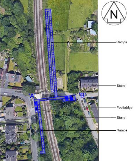

Another piece of the TransPennine puzzle: subject to funding, NR plan to close Lane Anne Level Crossing & Batley Signal Box by the end of 2022. https://www.networkrail.co.uk/runni...nnine-route-upgrade/lady-anne-level-crossing/
Network Rail said:
We are conducting a feasibility study to examine the option to close Lady Anne level crossing and Batley signal box by the end of 2022, subject to funding.
This study is being carried out to enable major railway improvements between Dewsbury and Leeds as part of the Transpennine Upgrade – such as faster, more frequent and more reliable trains – which the continued use of Lady Anne level crossing would restrict.
We are also generally aiming to eliminate safety risks by removing level crossings where possible and creating a safer railway.
Our monitoring shows that over 100 pedestrians use Lady Anne level crossing each day and we understand it is vital to maintain pedestrian access across the railway if the crossing is closed. This would most likely be in the form of a footbridge, and a questionnaire has been shared with local residents and community groups, whose input and feedback we would welcome.
As our investigations progress and plans are developed we are committed to keeping you updated.
Resident feedback
As a local resident and potential user of the level crossing we would like to understand the impact any works or changes to the crossing may have on you. Your feedback is invaluable to help us both minimise any disruption and to enable us to deliver the best solution possible. The questionnaire will be available from 8:00 on Monday 1 June and closes at 00:00 on Thursday 18 June.
Complete resident questionnaire
Footbridge design plans
We are at early stages of developing designs for a potential new footbridge, however we would like to share with you two potential options. Please see the drawings below. It is important to note that no decision has yet been taken on which design to adopt and that they are subject to change and further development.
Option A
Blends in well with the environment with ramps below the tree level to help address previously raised concerns.
Distance from points ‘A’ to ‘B’ are:
  • Using ramps – 350m
  • Using stairs – 200m
  • From Rutland Road there is street level access to the footbridge over the railway.
Option B
More visible with no trees to hide the bridge/ramp on the North side
  • Using ramps – 314m
  • Using stairs – 56m
  • The land to the North of the footbridge is outside of Network Rail’s land boundary.

takno
5,071
Good as ever to close level crossings, although I can't for the life of me see why there isn't a middle option where the bridge is at the option B location and the ramps are still run down through the trees, in broadly the same place as they would be for option A
Perhaps you should reply to the consultation with your (sensible) suggestion!
Out of idle curiosity I wonder how many people use these very long zig-zag ramps, and how much it costs to construct and maintain them? From the costs I've seen given for a less elaborate crossing without ramps this one must be well in excess of £1m, maybe nearer £2m! The cost per person crossing must be enormous! I know, a bridge is necessary, lifts are not the answer and this is a digression onto another topic.
Spartacus
25 Aug 2009
2,928
Possibly due to the embankment there the ramp would either be too steep by modern rules, or exceedingly long. It's already 36m longer putting the bridge in the place to make it shortest on option A. As described I imagine total ramp distance would be over 400m! o_O
I think Woodlesford, a fairly simple scheme, came in at £1m about 10 years ago, this, with a good amount of groundwork, and potentially a decent slice of land purchased, could easily be around £2m.
