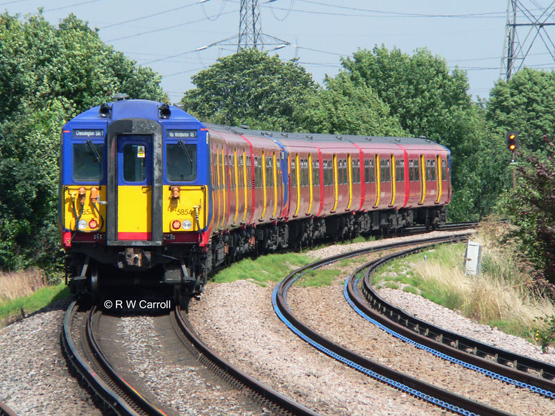

There is, or was, a 3-aspect signal just north of the platform on the up line at Malden Manor. The Chessington branch has two-aspect colour lights but the Epsom line is 4-aspect towards London from Worcester Park. The signal shows yellow, when the next signal protecting Motspur Park Junction is red, two yellows when the signal after that just before the level crossing immediately before Motspur Park is red but the route is clear through Motspur Park Junction itself, and green when the route is cleared through to the platform at Motspur Park. Here it is showing two yellows a few years back:
P1050276 by Robert Carroll, on Flickr
