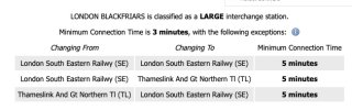

This has got me looking at various stations I know/use. For example Blackfriars
This doesn't make much sense to me. The lengthiest potential walk at Blackfriars is when you are changing between Northbound and Southbound Thameslink services (if you alight somewhere near the middle of the train).
Connecting between SE services (ie the bay platforms) and TL northbound is the easiest.
The table doesn't reflect any of this. I'd say it should be default 5 mins interchange, perhaps with a shorter time for SE<>SE (which would rarely happen anyway) or SE<>N-bound TL
I think there will be problem here, as specifying a longer TL-TL interchange time, then the same direction change which can be made within 1 minute will be made excessive.I note that southern<>southern is already specified as 5 mins instead of 10 at Clapham Junction. This makes sense as you don't have to cross the lengthy middle section of the bridge that's only necessary to get to SWR or overground services.

The case may only works if all Thameslink services do run through Blackfriars to the north.Maybe if anything needs to change it's the inability to take into account direction.
I can see now why Blackfriars has been set at 3 mins - it's in anticipation of many people changing here between TL trains going the same direction. The problem with this is that changing between TL services in opposite directions is something people are likely to want to do at Blackfriars. It's something I quite frequently do myself...and I now understand why I'm often surprised by how close a connection I'll be offered on journey planners, at Blackfriars.
It seems to me that not much would be lost by increasing it, because you could leave Farringdon at 3 mins (or even less) and let journey planners suggest people change there instead of Blackfriars. Any same-direction change that works at Blackfriars can also be done at Farringdon. And there would never be a reason to do a direction-change on TL at Farringdon.
