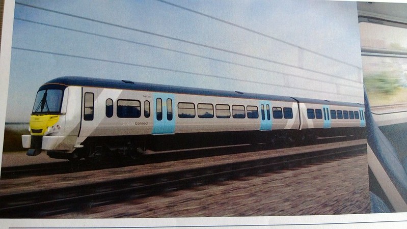

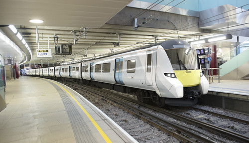

TSGN, just checking, is that the 'NX' livery as demonstrated on the latest 700 stock impressions? Is that also what FCC are repainting their 365s into over the C6X refurbishment?
This is what I've call the TSGN livery
Siemens Desiro City @ Farringdon by Sparkyscrum, on Flickr
365 in TSGN livery. by Sparkyscrum, on Flickr
