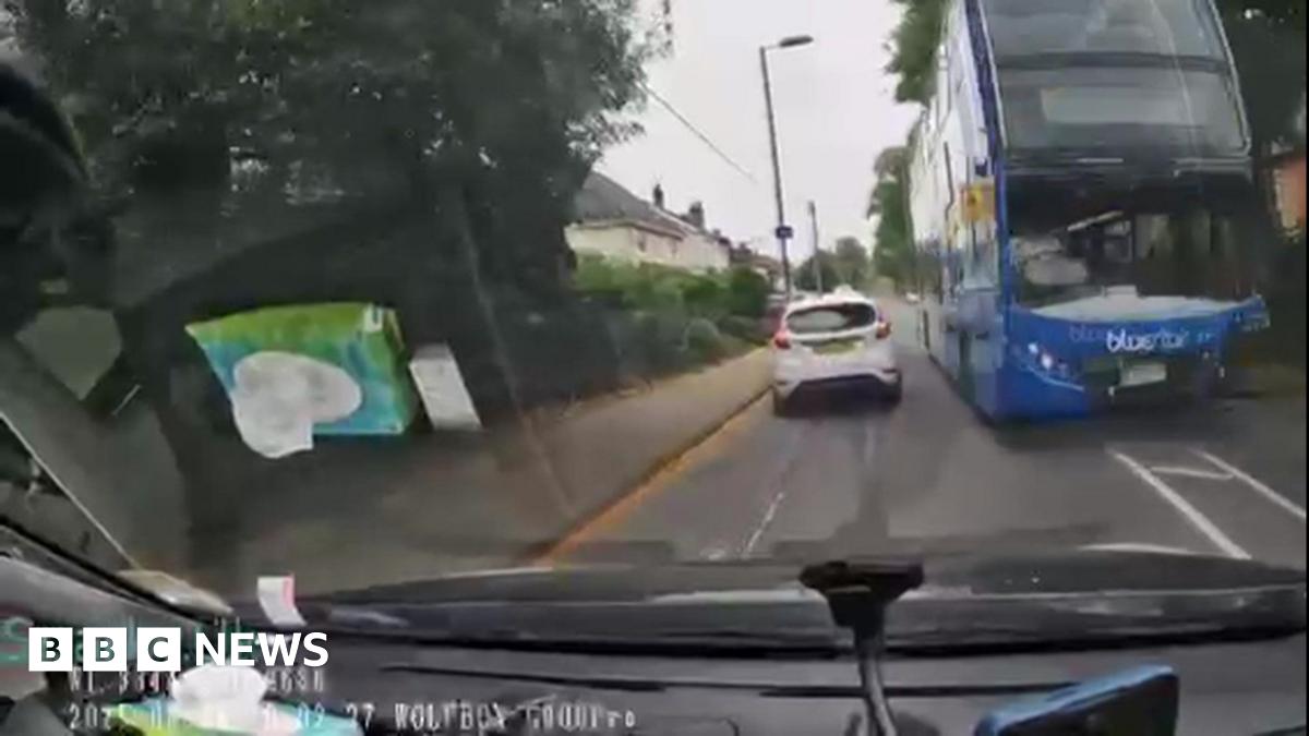

Looking at the dashcam footage, it looks like the driver headed for the river as somewhere (anywhere!) to stop the bus. No driver training will include this ... how could it?
