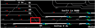

I imagine the line at Colton would have been blocked due to the work needed to replace the points. Cranes etc.
15,183
Bristol
I suspected as much - do you happen to know which crossing unit it was? I've seen hints it was on the Down Main/Normanton but haven't seen any formal confirmation.
