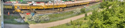

Final set of photos from yesterday from me.
There was a crane working at Shepreth junction. Looked like it was lifting the telecoms cabinet/room, presumably to the new concrete pad just south of the junction.

Some photos from earlier today. The edge for platform 3 has been extended and the OLE to the north of the busway bridge is now partially wired up. There was lots more activity down by Addenbrookes road but I did not have time to go have a look there today.
Anyone have any ideas what the blue pipes are for?
