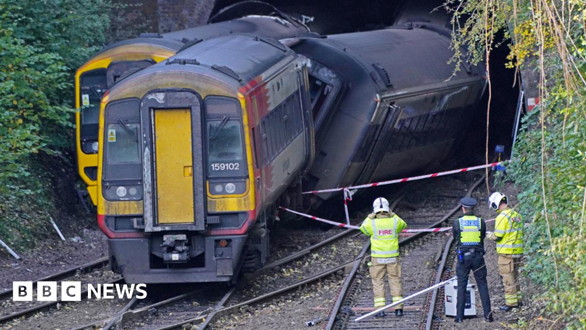

https://www.bbc.co.uk/news/uk-england-59114569 said:
A Network Rail spokesperson said: "At around 19:00 GMT this evening, the rear carriage of the 17:08 Great Western Railway service from Portsmouth Harbour to Bristol Temple Meads derailed after striking an object on its approach to Salisbury station.
"The derailment knocked out all of the signalling in the area.
Also BBC with a much clearer photo this morning of how the two trains have ended up where they have.

The photo of where the trains ended upwould indicate to me that the Waterloo train was going quite fast, it has almost completely entered the tunnel. Maybe it was fortuitous that the derailed train was leaning over so as to give more room inside the tunnel in effect. Or maybe just the kinetic energy of the colliding train had to go somewhere.
Given the forces involved it seems really lucky that there weren't more severe injuries and a testament to the strength and integrity of the stock.
This picture does indeed clarify the location and attitude of both trains. As a slight aside BBC South TV News throughout this morning are stating that the SWR train was travelling from Portsmouth. I have tweeted that they should check their own National News source!
