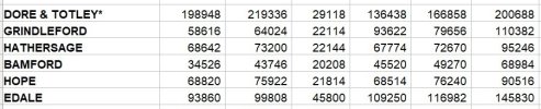

Surely Hope needs to be included in any semi fast. It always seems to get plenty of passengers (moreso than Grindleford anecdotally).
Not according to the ORR annual passenger number statistics, here for the last 6 years available, 2018/19, 2019/20, 2020/21, 2021/22, 2022/23, 2023/24
Trains cross in the Bamford/Hope area. More buses theoretically offer interchange possibilities in a bus turning circle by Bamford station and Derbyshire CC has been trying to encourage that.
Bamford was skipped by several services until December 2022, as were most of the others, helping to explain the latest increases. (There may be some split ticketing explanations as well, particularly at Grindleford, but they're hard to calculate.)
