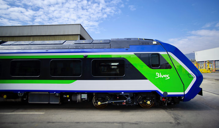

Hitachi has the tri-mode (diesel, battery, electric) Massaccio train, used on Blues services
