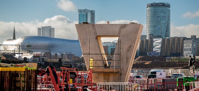

The first viaduct pier for the approaches to Curzon has been cast, looks to be at least one or two more in-progress.

There's a lot of foundation work completed for these piers at Curzon St. I think I saw 3 of the V formers either in situ or ready to be placed last week.
Seems to be starting to physically appear which is fantastic!

Also, we're up to 10 piers formed at Curzon Street now. Starting to visibly grow on the site.
