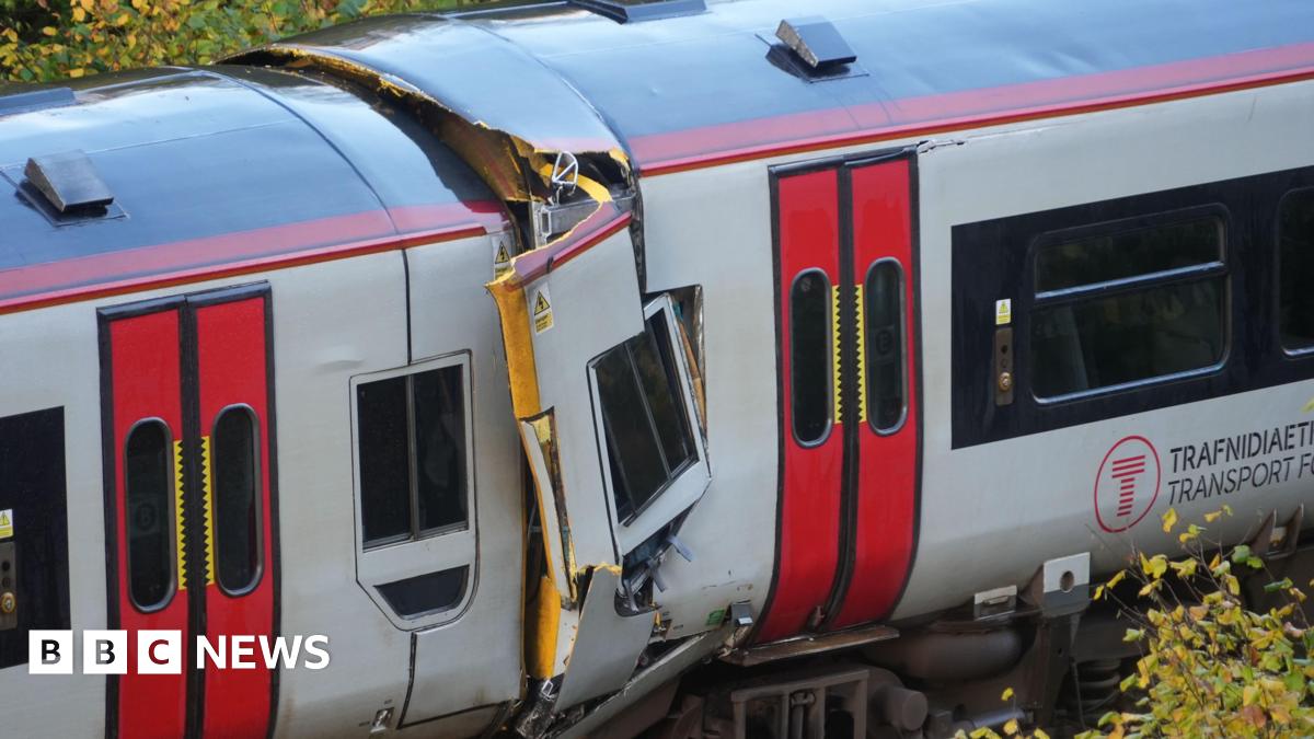

Looking at the photos, it appears the down train has managed to travel around 900 yards beyond the end of the loop. That’s quite some distance, but the gradient there does fall very steeply towards Machynlleth.
This should have given the driver of the down train enough opportunity to leave the cab, but clearly this doesn’t seem to have been the case for the up train. Looking at the way one of the trains has taken the brunt of the collision, it does seem likely the ETCS may have brought that train to a stand. If that’s the case then it will have very significantly reduced the severity of the incident.
Whilst there does seem to be some attempt to play this down as a “low-speed collision”, this is clearly a pretty serious incident.

Using Google maps and sky new helicopter views of incident the impact was 0.6 miles beyond the points at the loop.
