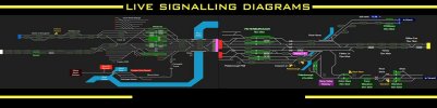

Interesting to see the treatment of London Waterloo (Traksy is provided rotated as well as right way, purely to match the other two).
Every map has something the others don't.
OTT seems to indicate slips well; they are on SignalMaps, but not on Traksy.
Traksy is less clutterred and, based on above discussion, perhaps more accurate in terms of the track layout, with some S&C numbers too.
SignalMaps has more horizontal compression and a black background (a good or bad thing depending on your PoV).
Railcam is behind a paywall, so can't compare, but this was on their website:
(Traksy unrotated)
