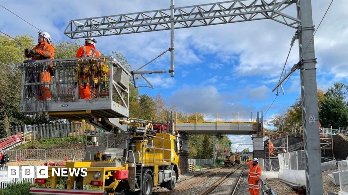

Network Rail has issued press release confirming section to South Wigston will be live from Sunday 28th July
BBC are reporting it
The next stretch of the project will be between Syston in Leicestershire and Trent Junction, north of East Midlands Parkway station.
Ms Webb said Network Rail will go back at a later date and make upgrades on the line between South Wigston and Syston, which includes the area around Leicester station.
