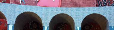

Today I replaced the drawing pins with larger head nails, painted the edges grey and glued the wallpaper stonework on underneath the arches.
I first tried trimming and sticking but in the end sticking and trimming with a craft knife turns out to be better.
I have used a combination of double sided tape (to make it stay) and wallpaper border glue as it is super sticky

Todays progress is the front side of the viaduct (I will not do the rear as it is out of sight. Part one added, held by double sided tape & glued on with wallpaper border glue & then the arches trimmed out.
Once tried & tested I have added the rest - taped edges, glue the rest. What you may see above is that where the glue was thicker the paper has turned a bit green, At first annoyed but it actually looks like moss!
And with the off trims I did the rear parapet wall
Next is trimming out the arches, covering the rest and then the detailed work - my weak point!
23rd and the next steps
First I have cut out the arches. It turns out cutting out most of the paper & using the knife to finish works better
I have used a Metcalfe P0210 paving slab kit to do the arch stones. I have used their sticky back to stick them but expect that I might need to re-stick them so I have tried just 1 arch first.

Last night I installed the viaduct in place but it was too dark for a good shot, so here are the pictures of it in place!
with locos on for scale
My next task is of course to finish the stone paper, the edging & trims, coping stones, getter etc and of course when finally available track!!

Today I have started again working on my viaduct.
I have used the thin plasticard on the arches underneath. I have used PVA glue to stick them in with drawing pins as temporary fixings. I think I need to get better large head nails to fix it more permanently.
View attachment 87061 View attachment 87062
I have also fixed my first sheet of stonework in place to see how it sticks with PVA glue
Now its time to let the secret out of the bag!!
Its textured wallpaper :) This is what it looks like on the reverse!
Being wallpaper rather than printed printer paper, there are no issues with wrinkling etc, it went on just like wallpaper!!!
