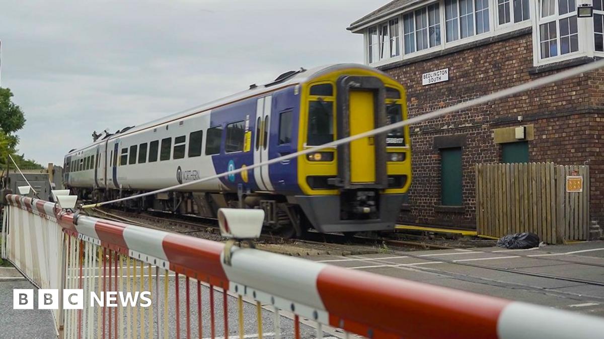

It‘s a busy level crossing on a through traffic route, so I suspect the bridge requirement was a part of the level crossing risk assessment, the existing crossing would have been just at the north of the platform ends. So in other words it isn’t some sort of unrelated “gold plating”.
But on the other hand theres a similarly placed level crossing at the south end of Bedlington station, and that’s staying.
15,052
Bristol
I wasn't suggesting it was over-engineering, just that the reason the cost to the project has trebled is that they were expecting the bridge to be funded under a different scheme maybe and now the DfT have pulled a fast one and Northumberland Council can do little else but dig up the cash.
To be fair the layout of the local road networks is quite different between those two examples - at Bedlington the main road off the dual carriageway actually goes under the line near the river, with Station road catering for largely local traffic. Also it's very close to the station so the lower speed for trains will make a difference to the safety audit. The A1061 at Blyth is the shortest route to the Dual Carriageway from the docks, and the nearest alternative route via a bridge would be straight through the town centre of Blyth. There's also space to put in a bridge at the A1061 which there isn't in the middle of Bedlington.
