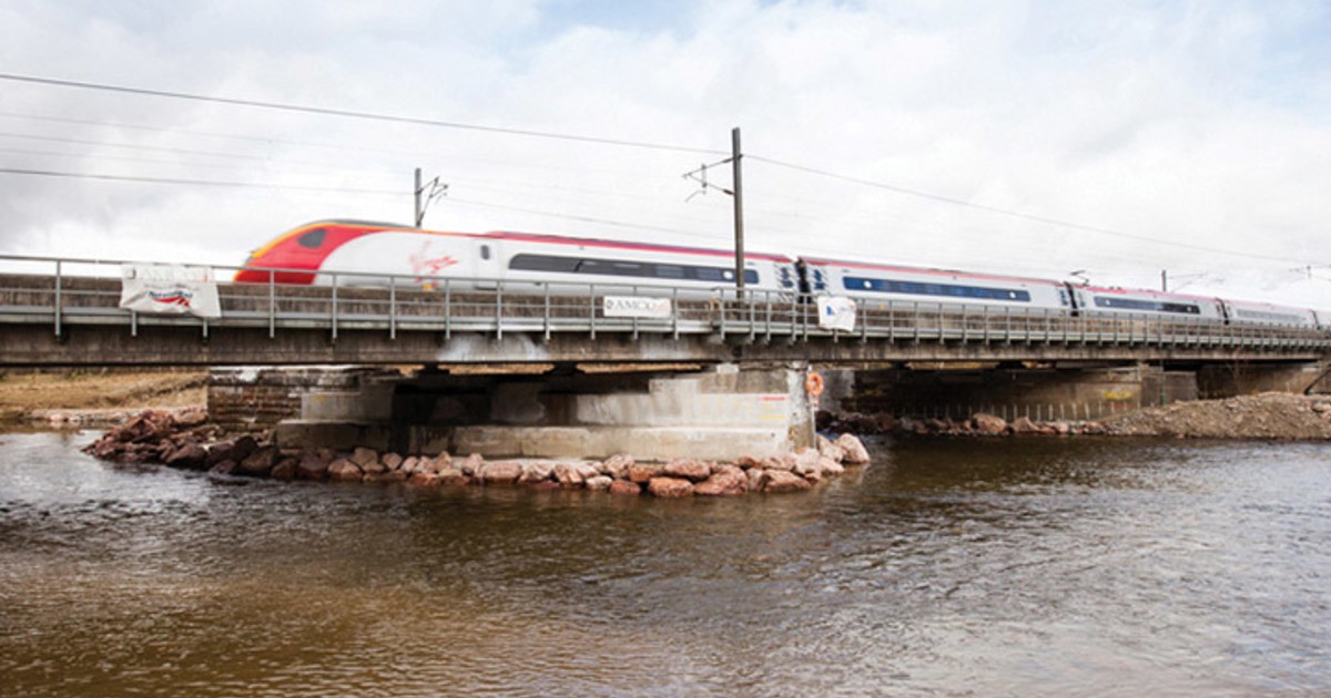

Here are 2 accounts of the works that were needed at Lamington.
In the Upper Clyde Valley the river snakes between hills and the West Coast main line (WCML) crosses it four times. The four span 101-metre Lamington viaduct is the largest of these crossings. It is all very picturesque, and the sound of the river burbling around the bridge piers is usually quite restful.
However, when Rail Engineer visited on 22 January, the noise from the River Clyde was much more pronounced and the ambience anything but restful. After overnight rain and melting snow, the Abington river gauge station, six miles upstream from Lamington, was recording the river level as 1.8 metres above datum, compared with its average 0.7 metres. Flooding of the site compound car park showed the rising water level.
Storms Desmond, Eva and Frank resulted in the wettest December since records began and created what the Centre for Ecology and Hydrology (CEH) described as “extraordinary” hydrological conditions. On the day of storm Desmond, river water discharge into the seas around Britain was a third more than the previous maximum. Published CEH statistics show that, during the month, the Clyde’s river flow was a record 249% of its long-term average.
On 30 December, storm Frank brought widespread flooding and disruption to Scotland. The M74 motorway was blocked by a flood at Abington, where the gauge station recorded the Clyde at its highest-ever level – 3.12 metres above datum.
As a four span 101-metre bridge, the Lamington Viaduct is the largest of 4 west coast mainline carrying railway bridges that crosses the river Clyde.
Following Storm Frank’s widespread flooding and disruption to Scotland on the 30th December 2015, the Clyde reached its highest-ever recorded level of 3.12m above datum.
After a train reported a dip in the track over the viaduct, examinations discovered that pier 2 had lost structural integrity. AmcoGiffen, with Network Rail agreement, closed the line to all traffic. We were subsequently contracted to secure the viaduct, produce the design and delivery of a reactive solution, and safeguard the structure against future issues.
AmcoGiffen’s Scope of Works
Mobilising on New Year’s Day – shortly after the blockage was reported – our team’s first job was to secure the viaduct. Creating a bespoke design solution, which required works to Pier 2, Pier 3, the North Abutment and all 4 spans, our overall scope of works included:
17,000 tonnes of rock armour protection
Underwater concrete pour of 400m3
Replacement of 4 bearings
Installation of 133 soil nails
Installation of concrete jackets
Bridge deck lifting
A new insitu cast concrete nosing to the upstream side of the pier 3
Associated grouting works
Grey bank protection upstream to both embankments
