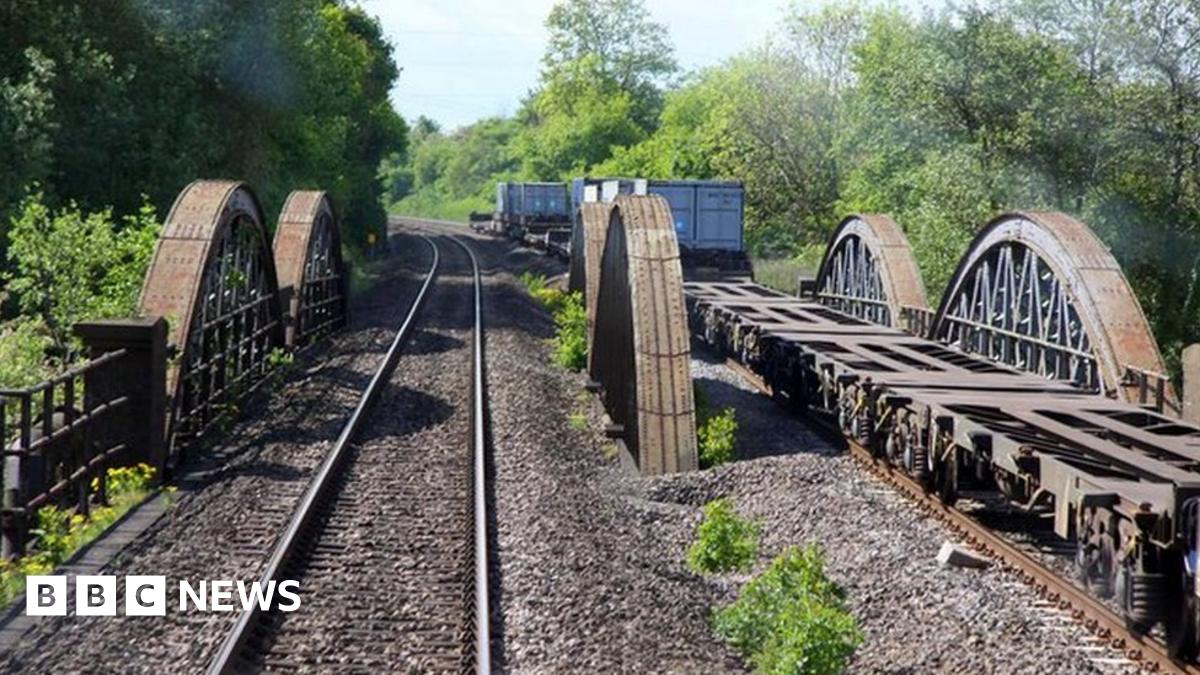

BBC is now reporting the story
It is strangely quiet here this evening - no work is taking place, but we can see the right-hand side of the viaduct appears lower than the left.
We know there was movement of the bridge structure, which was being monitored for several weeks.
Network Rail won't tell us what has broken or how serious it is - others are suggesting it will be shut for two weeks or more.

Appears to be third railway bridge on this line, and built in 1929.
There is some history of the river crossing and 2 previous bridges here
This is a google street view from towpath, note the two arches have been bricked up, and some buttresses added. The centre pier still has open arches. This suggests this pier has given trouble before but from style of bricks the strengthening was probably done 70+ years ago, maybe not long after 1929 rebuild

But it’s probably going to take weeks/months to fix this - according to the reports I’ve seen, the brick pillars have moved significantly.

Friend at NR sent me this from last week7E0923C6-A61F-465A-B034-0CD21BF9CD52.jpeg
Image shows damage to bridge, large crack where parts of bridge have separated.
