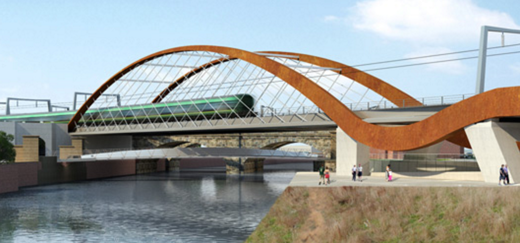

In this picture posted by jrb on Skyscrapercity last February, the line from Castlefield Junction to Ordsall Lane junction is just visible at the top. Next below it is Stephenson's bridge. Then comes the later metal extension to Stephenson's Bridge, which has since been removed. At the bottom is Prince's Bridge, which has also since been removed.
http://www.skyscrapercity.com/showpost.php?p=130745125&postcount=1428
Edit: Here's another view of Stephenson's bridge partly hidden by the now-demolished extension:
http://pconf.co.uk/i/KU5/5R19_H.jpg
I think the metal column is to remain as a reminder of the extension.
And here Stephenson's Bridge can be seen as it will be, behind the footbridge under the Chord bridge:
http://www.constructionenquirer.com/wp-content/uploads/Screen-Shot-2016-03-30-at-11.23.08.png
Stephenson's Bridge is also visible (with a buffer stop on it) in this view of the Chord:
https://www.railengineer.uk/wp-content/uploads/Ordsall-Chord-Manchester-1.jpg

Unless the Stephenson's bridge can be put to some form of practical use (e.g. visitor's area/viewing point) it just seems to me like a pointless blight.
Then again, it would probably have cost a fortune to demolish.
snowball
4 Mar 2013
8,111
It's a grade 1 listed building. There was a big fuss about the demolition of lower-grade listed buildings that delayed the project and nearly killed it. They would never have got approval to demolish Stephenson's bridge.

I think the canal/river paths underneath are being enhanced and the bridge lit up to show it off.
26,767
On the contrary, it would have been much cheaper to demolish the whole lot. A fair bit of money is being spent on restoring Stephenson's bridge, including re-building the parapet* that was removed in the mid-19th century when the other rail bridge was built alongside it. However it is contemporary with the and adjacent to Liverpool Road, arguably the oldest railway station in the world to survive in something like its original form, so I suggest it is worth keeping.
