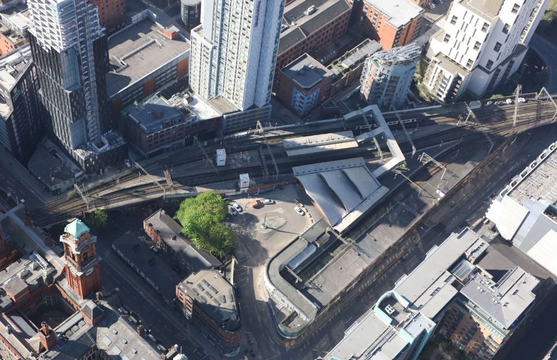

The restoration of 2tph to Manchester Airport is dependent on the rebuilding of Manchester Oxford Road to provide an extra two paths on the Castlefield corridor. I’m not sure when that’ll be completed though.
Manchester Oxford Road Station is situated on the Castlefield Corridor, a busy stretch of railway between Deansgate and Piccadilly stations. It is a key interchange station, providing connectivity to the wider rail network.
Due to the current layout of the station and tracks, movement of trains through the station is limited. This is hurting both train performance and limiting growth. Without remodelling the station, we will not be able to increase the numbers of passengers or trains calling at Oxford Road. This is especially important at peak times when passenger flow is already limited.
