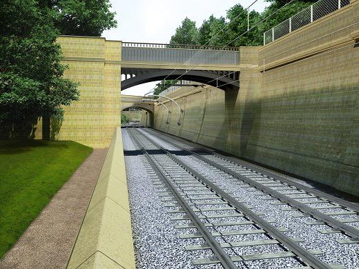

Leaving accusations of "it's who you know" aside, these backside-covering clowns also proposed the more sympathetic twin track cantilever design that was planned to be installed in Sydney Gardens (Bath) before wires west of Thingley Jct were canned.
I reckon, if the houses are screened off with the aforementioned safety glass, a design similar to this one could be part of a solution to the Mossley conundrum.
Unfortunately a nice support doesn't give you physical separation about 30ft above rail level.
Yes, I agree that Sydney Gardens were protected by an outcry after people had seen how much steel was being used elsewhere: http://www.newsteelconstruction.com/wp/wp-content/uploads/2015/01/Railbox1jan15.jpg shows a massive overhead girder, very different to the relatively light WCML gantries that are still in use 50 years later, and I can't find a picture of the things installed around Westerleigh Junction. Maybe they are so gross that no-one can be bothered to take a photo of one?
The requirements for the WCML OLE 50 years ago were very different to those on the GWML - 1 pan at 100/110, as opposed to 2 at 140. I do think that a lot of the GWML structures are overkill, but that is the consequence of going for a high-output, modular system designed to avoid using headspans at every opportunity. The fact that it's come in far over budget is for another thread entirely!
