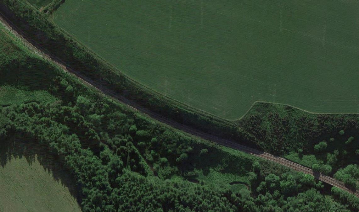

I was thinking this, if it's hit a landslip, it must have done so before the bridge
We aren't sure that it hit a landslip. What we do know is that a landslip near Carmont blocked the line, so it was reportedly heading back to Aberdeen having crossed over to the correct line.
Edit: Has anyone managed to determine exactly where this happened - I'm presuming at Northern end of the viaduct over the Cowie Water?
Nevermind - it wasn't as close to Stonehaven as I thought it was.

I don't think it hit a landslip. It looks like possibly the tracks was undermined.
Of course i'm just speculating and am no expert.
Chris B
28 May 2008
185
'Hitting' landslip would possibly be also the land slipping from under/to the side of the rails leaving PC & leading coach to go sideways down the resultant slip, following the earth - not the earth slipping from above down to the track....from the photos, it looks like the former.
Edit: to say 'snap' to the poster above mine!
