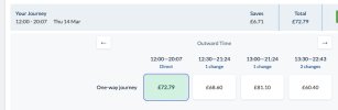

A journey I do quite a bit is London-Inverness. Aside from the sleeper there's one train a day that goes right through - an LNER one and that's the only route that a conventional search will give you an advance fare for. Otherwise you're basically looking at on off-peak. There's no "LNER + connections" type fare for this route, for example.
Anyone who does this semi-regularly is quite likely to understand there's a very obvious split - London to Edinburgh with LNER and then Edinburgh to Inverness with Scotrail. And often you'll find that this will beat the walk-up fare by quite a bit.
So ... if I ask trainsplit to look for tickets, it will quite likely find the split that I already know about, and it might "save" me £50 and charge £5+ for doing that work. But to me, that feels like I'm paying for something I can easily find myself. On the other hand... it might (and sometimes does) find me a more complex split, perhaps a string of different tickets for the LNER leg and/or the scotrail leg. In that case it's a bit different because it's very unlikely I would have found that myself. However... the additional savings in the fare are quite marginal - maybe it beats the "obvious" split by £1.50 (in terms of the raw fares, before adding the fee). But once it adds £5+ back on top of that, it's asking me to pay more than I'd have to pay if I'd just looked up the obvious split options myself.
Another scenario on the same route (I'm just using it as an example because it's one I'm familiar with):
Take the 14th of March - if I look on LNER it'll offer me £79 on the 1200 direct train. For the 1300 train, it'll tell me it's £106.60. Screenshot showing this:
If I ask trainsplit about the same day, it'll offer me as per this screenshot:
£73.42 for the 1200. Well done to trainsplit - they beat LNER. And many people will be quite happy to accept this lower price. Even if they see that £1.19 is taken as a fee - that's not much. I'd pay that rather than faffing about doing it manually.
What if I'd kind of prefer to travel at 1300 though? Trainsplit offers me £81.80, which is more than the straight-up LNER advance on the 1200 service. That's only because of the "share of saving" fee though, which is £4.50, as seen in this screenshot:
If that fee were instead £2, then it would still beat the LNER price.
This is a rather marginal difference perhaps, and you might say a contrived example. But perhaps I could find another day where trainsplit can't beat LNER on the 1200 train price, and then a customer might look at their options and go for the LNER one when trainsplit might have got their custom had the fee been a little lower.

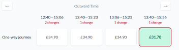

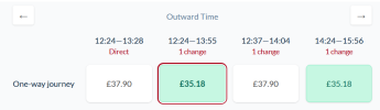

How intensively does the journey planner search for splits outside of the permitted route between two destinations? How does that affect commissions calculations?
For example, Sheffield - Birmingham has the permitted route of BY so is not valid via Nottingham. If I go on the site right now and search for Sheffield - Birmingham single for flexible fares at some date (say, 14th of March) on the cheapest setting, with advanced routes turned on, the cheapest fares are:
35.18 if I use the default settings, for Sheffield > Willingdon > B'ham Stations
31.70 if I force via Nottingham, for the exact same tickets
The difference is, of course, the commission from the first one being a split ticket saving along a valid route. It does seem somewhat weird that the engine will offer two different prices for the exact same ticket, though, just because I used different settings to search for them.
There have also been situations where I am able to find advances via Nottingham whose ticket sales prices are actually cheaper than those via Derby; I can't seem to reproduce them here currently, possibly a fluke or maybe only happens on certain days. But the question does remain: when there are cheaper options that involve a split ticket going outside of the original permitted route, is that taken into account?

I am finding that Trainline are cheaper than the forum site and just wanted to flag - I regularly travel with last minute advances from Fratton to London pre 10am. Usually Trainline will spit out a split at Woking or Haslemere - cost is £26.79 including their fee (and this is pretty typical on that route).
The forum site is £28.22 with the same split - I presume this is due to the booking fees being a % rather than fixed but flagging in case there is something that can be done to improve this.
